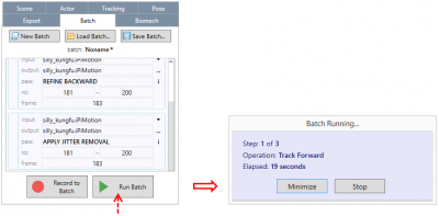

Execution of Batch Processing
Batch can be executed as soon as the following conditions are valid:
  • Current batch is not empty and contains at least one uncompleted step.
To execute batch processing just click Run Batch button on the bottom of Batch tab. As a result all processing passes from batch steps will be performed one after another.
Note: If required, you can break batch execution by clicking Stop button.
