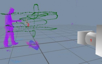

Calibration Sequence
Sample calibration video file and appropriate iPiCalib project which is result of processing in iPi Mocap Studio:
| ↓ Download video file ↓ two_kinects2_calibration.iPiVideo 339 MByte |
| ↓ Download calibration file ↓ two_kinects2_calibration.iPiCalib 99 KByte |
How to use:
- Download and install iPi Mocap Studio.
- Download both above files and put them all in one and the same folder on your hard drive.
- Run iPi Mocap Studio, click Open button or press Ctrl+O and select two_kinects2_calibration.iPiCalib file downloaded on the previous step.
- Now you can "play" with resulting calibration data in iPi Mocap Studio.
- If you want to try to process source video file by yourself then:
- click New button or press Ctrl+N;
- select two_kinects2_calibration.iPiVideo file downloaded before;
- choose Calibration project type;
- switch to Calibration tab and push Calibrate Based on Light Marker button;
- after calibration is performed, hide background using View > Hide Background menu item and turn on View > Show Depth from All Sensors item;
- now you can visually check the quality of the resulted point cloud.

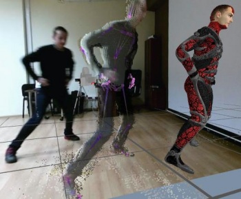

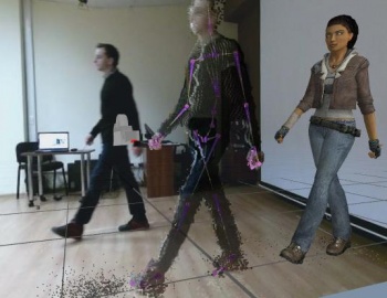

"Walk" Performance Sequence
Sample performance video file with walking movements and appropriate iPiMotion project which is result of processing in iPi Mocap Studio:
| ↓ Download video file ↓ two_kinects2_walk.iPiVideo 122 MByte |
| ↓ Download project file ↓ two_kinects2_walk.iPiMotion 450 KByte |
