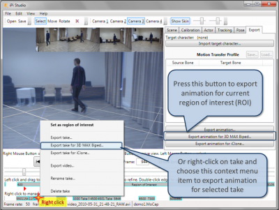

Use File > Export Animation menu item to export all animation frames from within Region of Interest (ROI).
To export animation for specific take, right-click on take and select Export Animation item from pop-up menu.

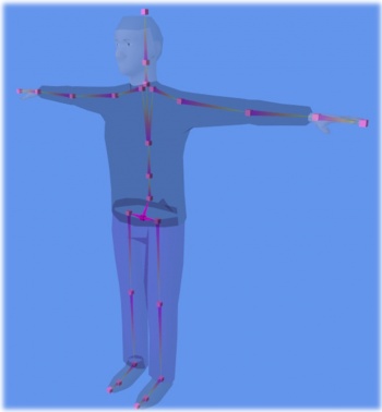

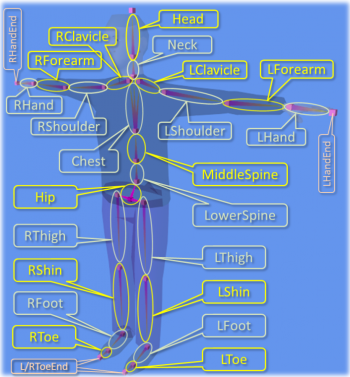

Default iPi Character Rig
The default skeleton in iPi Mocap Studio is optimized for markerless motion capture. It may or may not be suitable as a skeleton for your character. Default iPi skeleton in T-pose has non-zero rotations for all joints. Please note that default iPi skeleton with zero rotations does not represent a meaningful pose and looks like a random pile of bones.
By default iPi Mocap Studio exports a T-pose (or a reasonable default pose for custom rig after motion transfer) in the first frame of animation. In case when it is not desired switch off Export T-pose in first frame checkbox.

3D MAX Biped
Use the Export Animation for 3D MAX menu item to export your motion in 3D MAX-friendly BVH format.
Create a Biped character in 3D MAX (Create > Systems > Biped). Go to Motion tab. Click Motion Capture button and import your BVH file.
