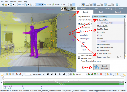

# Select ''''Export'''' tab
# Select rig or import model you want to transfer motions to (see details on motion transfer below)

Animation Export
To export tracked motion, follow simple steps below.
  1. Select 'Export' tab
  2. Select rig or import model you want to transfer motions to (see details on motion transfer below)
  3. Press Export button or use File > Export Animation menu item to export all animation frames from within Region of Interest (ROI).
    Note: To export animation for specific take, right-click on take and select Export Animation item from pop-up menu.
  4. Select output file format
