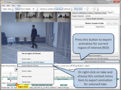

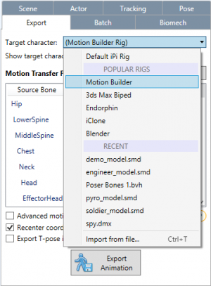

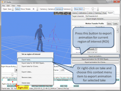

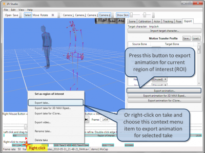

To export tracked motion, follow simple steps below.
- Select Export tab
- Select rig from the list of available rigs or import your custom model
- Note: The motions will be automatically transferred to selected rig (except Default iPi Rig, that does not require motion transfer). See details on motion transfer below)
- Press Export button or use File > Export Animation menu item to export all animation frames from within Region of Interest (ROI).
- Note: To export animation for specific take, right-click on take and select Export Animation item from pop-up menu.

MotionBuilder
Select Motion Builder target character on Export tab and export animation to BVH or FBX.

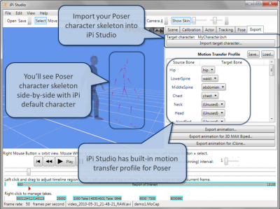

Poser
- Export your poser character in T-pose in BVH format (File > Export).
- Import your Poser character skeleton into iPi Mocap Studio. Your animation will be transferred to your Poser character.
- Export your animation in BVH format.
- Import exported BVH to Poser

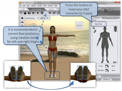

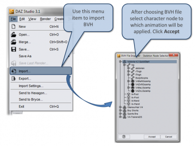

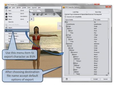

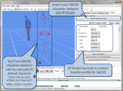

DAZ 3D
The workflow for DAZ 3D is very similar to Poser. Import your DAZ 3D character skeleton into iPi Mocap Studio (File > Import Target Character). Your animation will be transferred to your DAZ 3D character. Now you can use File > Export Animation to export your animation in BVH format for DAZ 3D.
IMPORTANT: You can use DAZ character in COLLADA (.dae) format for preview, but it is strongly recommended that you use DAZ character in BVH format for motion transfer. DAZ3D has a problem with COLLADA (.dae) format: DAZ3D Studio does not export all bones into COLLADA (.dae). In particular, the following bones are not exported: eyeBrow, bodyMorphs. DAZ3D Studio does not use bone names when importing motions; instead, DAZ3D Studio just takes rotations from the list of angles as though it was a flat list with exactly the same positions as in DAZ3D internal skeleton. As the result, when you transfer the motion to a COLLADA character and import it back into DAZ3D, the motion will look wrong. iPi Mocap Studio displays a warning about this. To avoid this problem, import your DAZ target character in BVH format - DAZ3D Studio is known to export characters in BVH format correctly (with all bones).
You can improve accuracy of motion transfer by doing some additional preparation of your DAZ 3D skeleton in BVH format. For DAZ 3D Michael 4.0 and similar characters, you may need to clamp thigh joint rotation to zero to avoid unnatural leg bending. For DAZ 3D Victoria 4.0, you may need to adjust foot joint rotation to change the default “high heels“ foot pose to a more natural foot pose.
iClone
Current version of iPi Studio can only export animation in iClone-compatible BVH format. The iMotion format is not supported as of yet. That means you will need iClone PRO to be able to import the motion into iClone. Standard and EX versions of iClone do not have BVH Converter and therefore cannot import BVH files.
Workflow for iClone is straightforward. Export your animation using Export Animation for iClone menu item. Go to Animation tab in iClone and launch BVH Converter. Import your BVH file with Default profile, click Convert and save the resulting animation in iMotion format. Now your animation can be applied to iClone characters.
