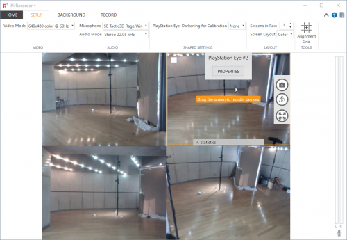

Setup
Setup view allows to adjust device and screen settings before recording.
Setup View
You can:
  • Select working video mode
  • Select microphone and audio mode
  • Adjust number of cameras displayed in a grid row to optimize screen space usage
  • Reorder devices within a grid.
    To place a device to a specific position, drag it's screen to this position. You can also throw away unneeded device if it has been selected by mistake, simply by dragging away it's screen.
    Tip: For convenience, it is recommended to place cameras in the same order they go around the capture area – either clockwise, or counter-clockwise. However, you're free to use any order you like.
  • Select display layout for depth sensors screens when both depth and color are present.
  • Set global properties for a group of similar devices, if there are any.
    Example of such property is Darkening for Calibration for PS Eye cameras. Global properties are found in the Shared Settings group in the ribbon.
  • Set properties of individual cameras.
    Examples of such properties include brightness and contrast for color cameras, and elevation angle for Kinects. To access individual device properties, press the Properties button in the device's screen overlay.
    Tip: Program remembers settings values and restores them on the next run automatically.
Note: Display settings you are making in the ribbon the device's screen overlay do not affect the recorded video. For example, if you turn on mirroring then image in video won't flip correspondingly. If in depth + color mode you change the layout to display only depth, both depth and color streams will be recorded to a video.

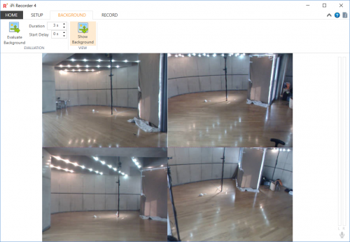

Background
Before you start to record any videos, you'll need to evaluate a scene's background. Background is a picture of static (not moving) objects in the capture area. Evaluated background is embedded inside videos and is used later to detect moving objects easily. Also, background is employed for compressing videos with the background subtraction method.
Usually, background should be evaluated only once during a recording session. However, any time the environment gets significant changes, you need to re-evaluate the background. Examples of such changes include differences in lighting conditions, introducing new or moving existing static objects within the cameras' field of view.
Background View
Before starting evaluation, you can set its duration. In general, the longer duration, the better evaluated background. Default duration of 5 seconds is sufficient for most situations. Less values can be set for testing purposes, when you trying out different settings for cameras.
PC running iPi Recorder may be located in some camera's field of view. Thus, to evaluate background, you need to go away from computer. But being away, you cannot start the evaluation process. In that case, you can set a delay for evaluation to start. So you'll have enough time to leave capture area after pressing the Evaluate Background button.
After background has been evaluated it is displayed automatically so you can check its quality. You can turn back to live video stream by toggling the Show Background button.
Now you can proceed to Record view.

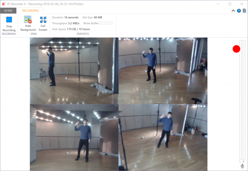

Recording View
During recording (the Recording view), some statistics are displayed, such as current file size, disk throughput, write buffer usage. Also, you can expand camera statistics to watch for frame drops and related stuff. All those values may help you to discover performance issues. For example, an overflow of the write buffer signals that you have low disk speed — you can try to increase compression ratio. Frame drops (if they appear only during recording) may indicate that your CPU is overloaded and you need to switch to less agressive compression options.

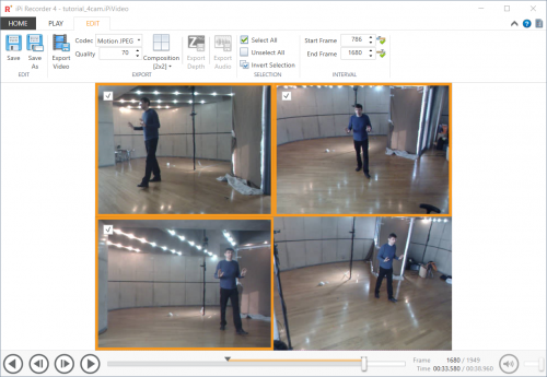

Editing and Export
iPi Recorder is capable of simple editing of recorded .iPiVideo files as well as exporting data to regular media files. To use these features switch to the Edit view when a video is open for playback.
Important! Edit and export features require an active license for iPi Mocap Studio on the same PC. The same limitations on camera configuration are applied as for tracking. For instance, if you have the Basic license, then you can edit/export videos with up to 6 color cameras or up to 2 depth sensors.
Edit View
Editing is essentially saving a subset of originally recorded data to the same or to another .iPiVideo file. There are two options to define a subset of video data to be used for save/export, which you can use separately or combined:
  1. Exclude data from some of the devices.
    Click on a device screen to select/unselect data from this device. Or use commands in the ribbon to perform group selection operations.
    Tip: This option is particularly useful when one of the cameras spoils tracking but you don't want to throw away the whole video. For example, the camera was moved during recording so its position in the scene is not accurate. Or the colors in that camera differ too much from other cameras.
  2. Select a range of frames.
    Use controls in the Trimming group in the ribbon to set range boundaries.
    Tip: This option is useful for trimming useless data from both ends of the video. If a video contains multiple takes, it may be convenient to save them into separate .iPiVideo files.
After you have selected the data to use, hit the Save button to replace the original file, or Save As to save the data to another file.
Video export produces an .avi video file from color streams of selected cameras or depth sensors. Besides selecting devices to export (and a frame range if needed) you should take care of a couple of other things:
  • Video codec used to encode a resulting video.
    iPi Recorder supports Motion JPEG (built-in), Xvid (if installed, on 32-bit OS only) and x264vfw (if installed).
  • When multiple screens are selected, choose how they are composed into a single video frame.
Press the Export Video button to select a destination file and run the export.
You can also export audio data only to a .wav audio file.
