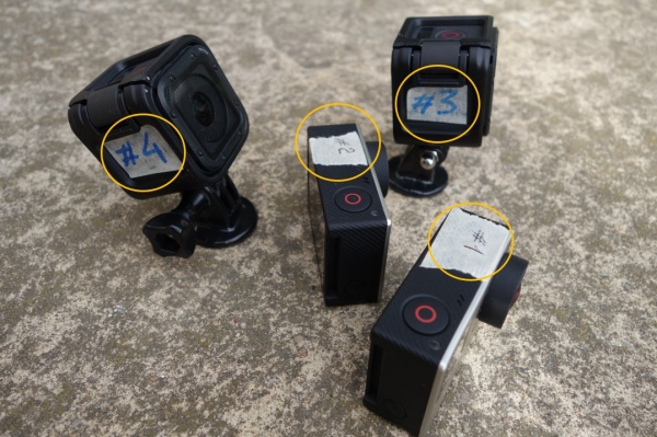

  2. All these cameras must be marked by some unique name/label to distinguish from each other.
    For example:
