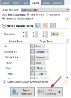

To start streaming, go to the Export tab and press Start Streaming button. While streaming is active any changes to a pose of the actor in Mocap Studio (playback, tracking, manual edit etc.) are sent to the local network. If there is a target character applied for an actor then the program streams poses of that target character otherwise it streams poses of the actor model. To stop streaming press Stop Streaming button on the Export tab. Streaming also stops automatically when a project is closed.
Note: Streaming of multiple actors is not currently supported. In multi-actor projects, it streams an active (currently selected) actor.
Streaming protocol broadcasts UDP packets to a certain port on the local network. By default, the port used is 31455. You can change this value in Streaming Settings dialog which opens when you press a "gear" icon on Start Streaming button.
