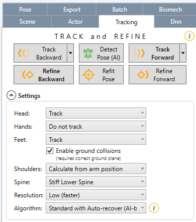

When one chooses AI-based tracking for Head/Hands/Feet, it applies during standard Tracking Forward / Backward pass along with iPi incremental tracking for full body. But when tracking has already been performed and there is no need to re-track frames in ROI, one can apply only AI-based tracking for Head/Hands/Feet (depending on selected settings for them). To do it, click on down arrow in the right part of Track Forward/Backward buttons and choose AI-based Only item in drop-down menu. This could be helpful during experiments with different AI options because it allows applying changes fast.
Note: If AI-based tracking is not selected for any body part, or tracking is turned off for all individual body parts that requires AI-based tracking, then AI-based Only option is not available in the drop-down menu.

Tracking with Auto-recover option
This feature is more intellectual implementation of Automatic tracking errors fixing. It is regularly compares the result of standard tracking with tracking that uses AI-detected pose as initial guess. If AI-based result is better, it uses it in the current frame and retacks back until it can improve tracking result. So if tracking error occurs, it is automatically detected, and misdetected frames are fixed. In most cases, this provides better tracking result and allows to avoid propagation of tracking errors to the subsequent frames.
How to track with Auto-Recover option:
  • Just select Algorithm option
    • Fast with Auto-recover (AI-based)
    • or Standard with Auto-recover (AI-based)
Additional time is required to compare with AI-based result and re-tracking, but this may save a lot of time as you would not need manual error fixing.
