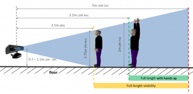

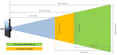

Maximum capture area is about 7 by 7 feet ( = 2 by 2 meters), for all sensor models and configurations.
It is convenient to put MS Kinect Sensor on a chair or a table. The picture below will help you to understand possible capture area and required space. Dimensions are different for Kinect and Kinect 2 sensors due to different field of view.

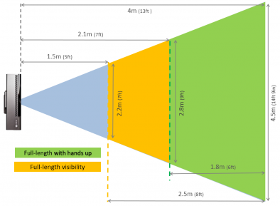

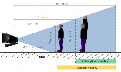

Kinect 2 for Windows and Kinect for Xbox One
Kinect 2 sensors have wider angle of view compared to first generation Kinect. This makes possible to come closer to sensor thus decreasing overall space requirements.
