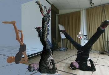

Here you can find sample videos and animations captured by two MS Kinect 2 depth sensors with the aid of Distributed Recording.
