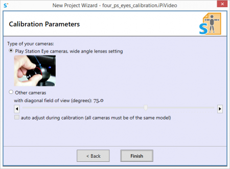

    • Set the diagonal Field of View (FOV) for your cameras.
    Note: If you use Sony PS Eye or Logitech QuickCam 9000 cameras, leave the FOV value at the default 75 degrees.
