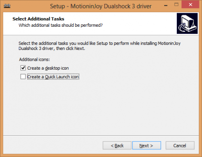

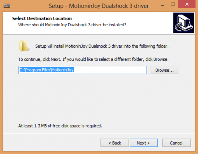

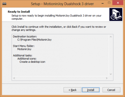

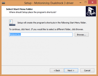

and allow User Account Control (UAC) to make changes on your computer by MotioninJoy Dualshock 3 driver Setup program. As a result setup wizard should start:
Follow on-screen instruction and change installation parameters if needed:
