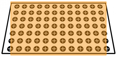

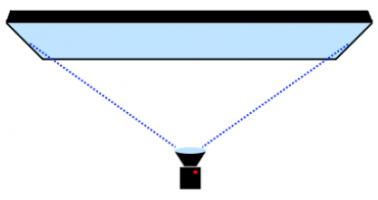

  • We recommend to use the following five view angles:
View Angle
How it Looks from Side
How it Looks from Top
How it Looks in Camera
1. Front
2. From the left
3. From the right
4. From the top
5. From the bottom
