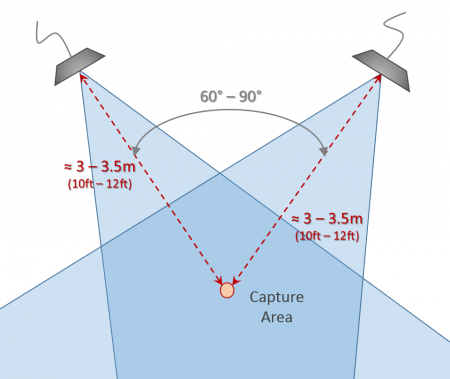

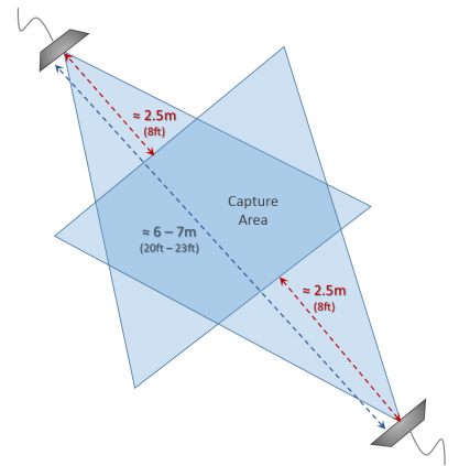

Dual Depth Sensors Configurations
There are two possible arrangements of the two sensors:
  1. angle between sensors is between 60 and 90 degrees;
  2. angle between sensors in near to 180 degrees that means that sensors are placed opposite to each other.
First configuration

Kinect 2
Kinect
