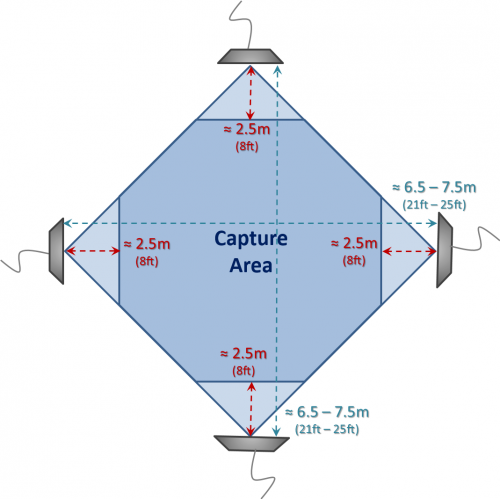

Ideally, depth sensors should be placed at apexes of equilateral triangle with sides equal to about 6 meters.
Ideal Configuration for Kinect 2
In practice it may not always be achievable due to available space size and configuration, mount positions, USB and/or power cord lengths, etc. Thus, sensor positions may slightly differ from ideal ones. Please look at the example from real mocap session.
Real-life Scene Configuration Expample
Four Depth Sensors Configuration
Ideally, depth sensors should be placed at sides of a square, each pair of sensors facing each other.
Tip: If you see much noise (many yellow points) in any pair of sensors, try to slightly change direction of one of the sensors, this may substantially decrease noise caused by mutual interference.
